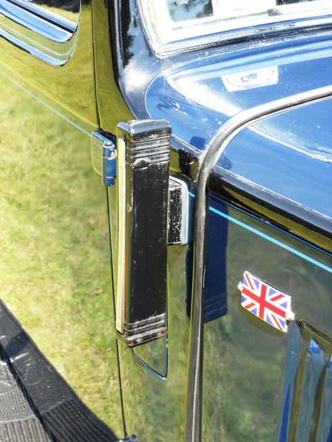

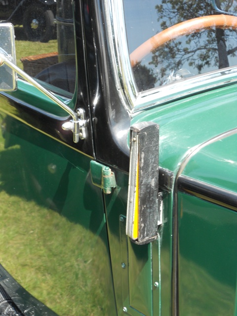

On the late '33 early '34 Ten (and open cars to 1935) the illuminating box trafficators were fitted on each side of the scuttle. There the driver could see if they were working or not, even if other road users could not always see them. The white cabriolet on the Home page has extended brackets to make them more visible to the cars behind!

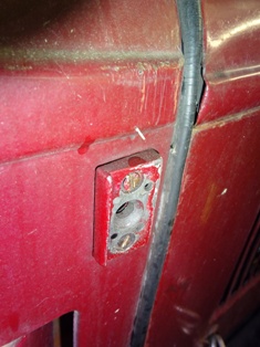

Tens fitted with them on the production line had a mounting bracket each side
Box trafficators vary in style
