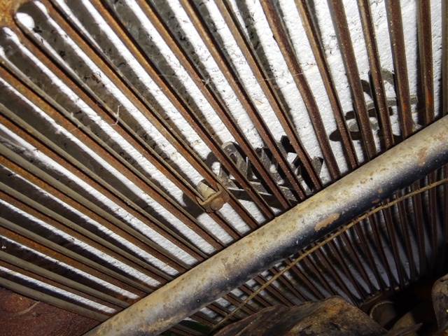

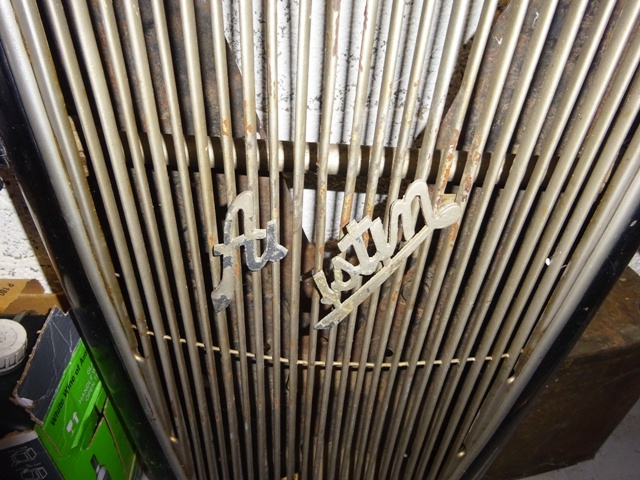

Post by peter_winney » Fri Aug 25, 2023 12:03 pm
The 5" badge with holes at the ends is for the chrome rad cars. The Austin script badge on the cowled rads including the Cambridge is longer (6" the broken one I have) and does not have holes right thru the ends but is fastened from behind.
Austin script badge - front view
Austin script badge fastening

Post by BrianEvans » Mon Aug 28, 2023 9:23 pm
Ah yes that’s exactly the same as ours and ours has broke in exactly the same place.😳

Post by peter_winney » Tue Aug 29, 2023 3:47 pm
BrianEvans wrote: ↑
I have plans to glue it with a strip behind in support but the difficulty will be fitting it to the car without removing the radiator cowling & grill

Post by peter_christie » Tue Aug 29, 2023 4:41 pm
Peter,
you can solder them with modern low temperature solder, but the metal, Mazak, zinc based alloy must be clinically clean. I have also glued it successfully using Bondic with U/V cure, but I wouldn't bet on how long it will last 'coz the U/V can't see through the metal.
(it's OK on plastic components). Gluing the whole thing on to a piece of tinplate and cutting it out with a metal-cutting fretsaw would work.
On the New Ascot, I could reach the screws from below - with difficulty!
