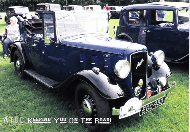

The chassis No. of your 10hp Clifton G126413 reveals that it was one of the open cars that remained in production alongside the Cambridge until 1937. Your date of 1936 will be correct, July or slightly later maybe. Your car may also have a body No. GPA 126713 - earlier cars had different Nos for body and chassis. It is likely it has a downdraft Zenith (introduced @ G105479). It may have Girling brakes and Easiclean wheels as the car in the picture below. I am not sure when these features first appeared on the open cars. Previous to that the export models had 16in wire wheels (unlike the 18in wheels of the UK cars).
The club sells an Austin Colours Reference Book (see Parts Department / Regalia / Books in online shop - website Home page) that lists the colours available for particular models and years and references some modern colour codes. Most Austins, certainly in the UK, had black wings, but this appears no longer the rule by 1936. The Cambridge could be had in single colours or with two tones of the same colour. It was also possible for the customer to specify a colour. Cars were often exported in knock-down-kit form for local assembly and local colour options may have varied.
