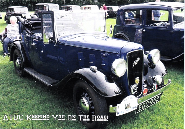

The chassis No. of your 10hp Clifton G126413 reveals that it was one of the open cars that remained in production alongside the Cambridge until 1937. Your date of 1936 will be correct, July or slightly later maybe. Your car may also have a body No. GPA 126713 - earlier cars had different Nos for body and chassis. It is likely it has a downdraft Zenith (introduced @ G105479). It may have Girling brakes and Easiclean wheels as the car in the picture below. I am not sure when these features first appeared on the open cars. Previous to that the export models had 16in wire wheels (unlike the 18in wheels of the UK cars).
