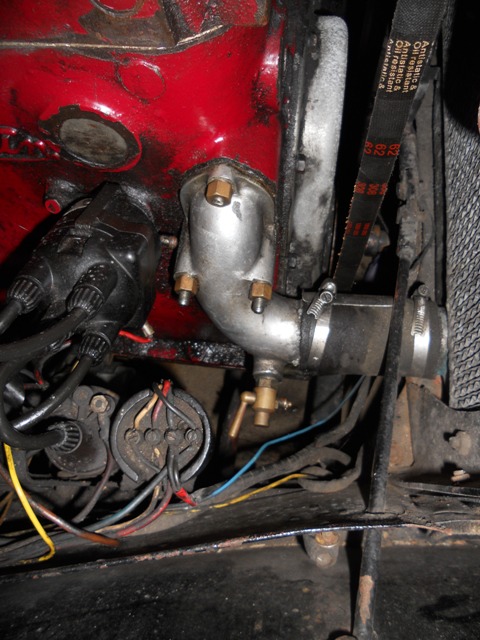

Posted: Wed Mar 10, 2021 6:55 pm
You will need to unbolt the aluminium bottom water branch (aka water elbow) to fit the short piece of hose over it and then bolt it back in place. While it is off it is worth flushing the cooling system well to get any much out. You may find that the water branch is corroded and needs to be replaced with a new one from club spares.

by norman_ball
Put the hose on the branch and fit them as a unit. BUT it will still be a b++++r because the branch has to be got on to the studs and the hose on to the rad at the same time. Best method is to remove the studs and bolt the branch up with correct length bolts. Looks neater too.

Re: Fitting bottom hose on a Sherborne
Posted: Sat Mar 13, 2021 2:54 pm
by david_mccullough
I have just been doing this on my sherborne this today, there has been a persistent drip since the engine was rebuilt and I took off the elbow to reseal it. It would appear to have gone porous as the water it oozing out near the top bolt. I went onto club spares to order a new one but they done seem to be in stock. Ive sent off an email to Rachel to see if Im missing the listing.
Posted: Sat Mar 13, 2021 2:57 pm
by david_mccullough
Peter, is that a piece of metal below the jubilee clip? I did notice a mark on my hose and assumed it was from the fan belt, so I must do the same.
