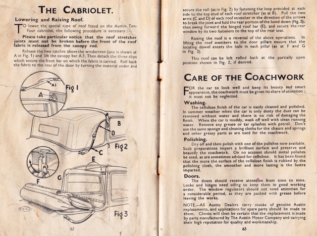

This is a picture from an old Austin handbook showing how the roof of the Colwyn cabriolet folds. It also shows some of the details of the stretcher bars, roof latches, pram irons, and the loops for holding the rolled up front part to the frame. It will not show all the detail you need - for example when the car was new the the rear part of the folding roof was lined but not the forward rolling-up part over the front seats. You will need to seek out details and photos from Colwyn owners.
The boot (trunk) details on the Colwyn cabriolet are the same as the Lichfield saloon. I will seek out some pictures to post on here or you, but again you will need to get details from Lichfield and Colwyn owners as I dont have any pics of the hinges.

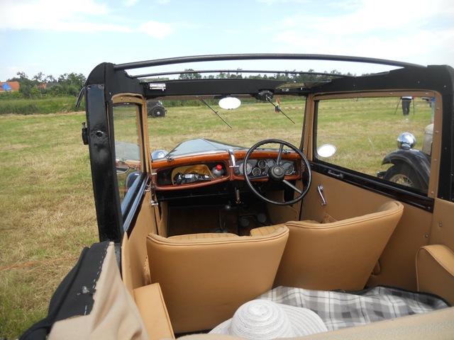

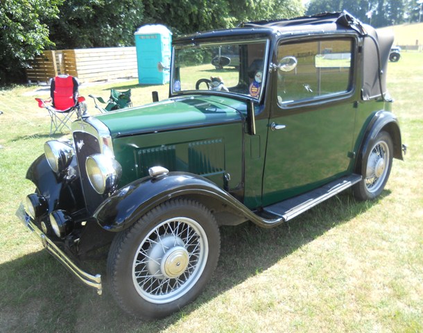

From your post on Facebook I see that your cabriolet is the earlier "chrome rad" model before Austin used names for the Ten range with the changes in mid 1934 to a cowled-radiator design. There are differences in the shape of the folding hood (roof), different bumpers (double-blade pattern on the earlier model rather than single-blade), and the earlier-style cabriolet had the spare wheel bolted on the outside of the drop-down luggage compartment lid (Colwyns have the spare inside and filling the luggage compartment). The catches on the roof are simple chrome slide bolts (as from any ironmonger) and not the fancy catches fitted to the Colwyn. The catches for the luggage compartment lid are similar to the Colwyn & Lichfield in that they use a carriage key type bolt with a flip up chrome cover. In the photos these look like top hinges but are not.
This pic shows the roof catches on the windscreen frame. When the roof is open the middle roof bar can be hinged back onto the rear bar, which is fixed.

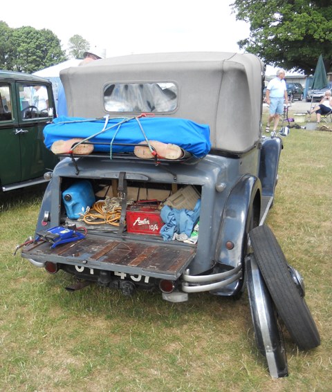

The final picture shows a car with the spare removed in order to open the luggage compartment fully. I believe this may be a "mod" by the owner to make full use of the space. The cabriolet that was lent to me briefly 50 years ago had folding brackets inside that limited the opening to a small gap

My Cabriolet is the last photo. (Very non-original as the car had no rear chassis member, boot lid, floor, hood hinges or hood when purchased.) I fitted a tow ball, a greatly modified Lichfield trunk lid and trailer hinges giving me a 5ft flat floor inside if needed.
As Peter says, the original cabriolet had a trunk that opened very little at the top. Mine is very useful now for taking rubbish to the garbage dump, collecting timber, cement etc.
Unfortunately the trunk lid is not the same as a Lichfield Austin 10 - ( different hinges, no curvature, restricted movement.) The spare wheel was carried on a holder on the lid which which is what restricted the opening. (Poor design in my personal view - the cabriolet bodies were made by an outside firm?)

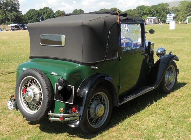

The hood is tensioned at the front, as per Peter's diagrams, with three hooks rivetted on a metal bar sown in the hood material which hook under a hinged bar. This tightens the material as the bar is lowered. Small bolts slide into holes in the metal arms of the hinged bar to hold the hood down with push studs along each side to keep the hood edge down. The chromed/painted outside hinges on the green car are correct and now expensive and very difficult to find as Rolls Royce used the same size and make in the thirties. Mountings would also be needed for these hinges - through the bodywork and on the main hood frame. Quite a major job without detailed measurements or a pattern. Best wishes
