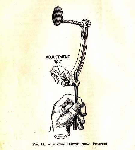

Colin
The Pitman's Book of the Austin Ten by Staton Abbey says:-
The adjustment should be such as to allow at least 3/8 in. free movement of the clutch pedal
It goes on say:-
To adjust the pedal movement, first put a tommy bar into the hole in the clutch operating shaft to hold it in postion (see Fig.14) Then slightly slacken the clamping screw at the bottom of the clutch pedal lever and depress the pedal sufficiently to give the necessary free movement. Securely tighten the clamping screw and check the adjustment.
In my experience difficulties that may arise include:
  • No hole in the shaft for the tommy bar so need to hold it with a Mole Wrench
  • Move the pedal the wrong way so end up without any free pedal movement (instruction says "depress" but you need to increase the travel not reduce it)
  • Move the pedal too much so clutch does not disengage fully
  • Clamp does not tighten sufficiently to grip - may need slot cleaning out and or threads repairing
  • Brake and clutch pedals reversed so neither can be adjusted correctly (clutch pedal has shorter stem fitting into lever)
