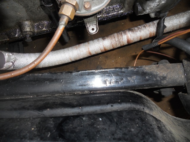

Photo shows stamped chassis No. on a Cambridge

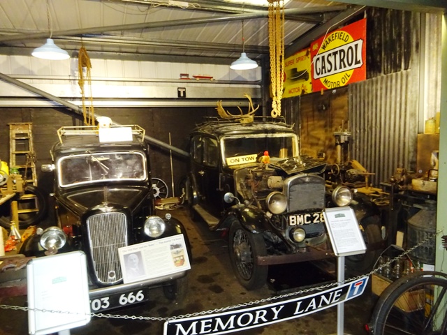

This looks to be a helpful forum and thread. I'm pulling together some details to help sell a tatty (barn-find condition) 1934 Light Twelve-Six (Lt 12/6) Ascot.
Does its F20757/15 chassis number mean that it was originally specified with a 15.9hp engine?
Engine is supposedly 1FF1631 (is this 1,711cc capacity?), though I've been unable to locate that number on the block yet. Car No. is F/BW 2900/15 and Reg No. is BMC 284 (London, 21st April 1934).
The car is currently on long-term display at the Atwell Wilson Motor Museum in Wiltshire. We however don't have the resources to bring it back to life and have decided to try to find a new home for it.
Chris T (volunteer at AWMM)
Re: Chassie numbers
Posted: Thu Feb 13, 2025 4:36 pm
Re: BMC 284 - Yes, Chassis No - F20757/15 indicates that this car had the "15.9hp" 1711cc engine from new. 1FF1631 is an early one. The option was only made available in 1934. The suffix on the car No. FBW 2900/15 also indicates a 15.9 engine. The 13.9 cars had suffixes /13. The 13.9hp engines had 1F as the prefix and by 1934 had been available on the Harley since 1931.

Yes, that is indeed the car. Well spotted. BTW it's for sale with or without the non-factory (although in-period) stag's head accessory.
