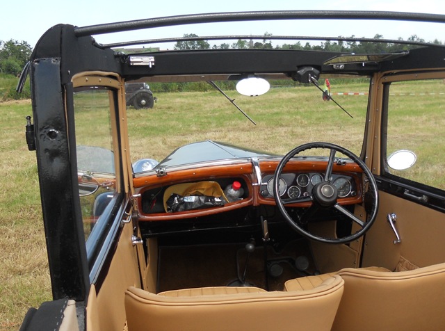

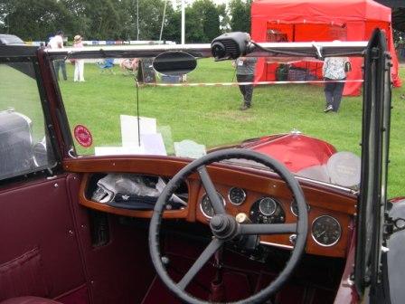

The change from 6v to 12v coincided with the change to X-chassis in July '33 @ G21000.
The dashboard & instruments are an easy-to-see indication
6v Ten has wooden dash with Lucas twin switch with ammeter & ignition light combined prominent in centre
12v Ten has metal dash with single switch, ammeter & ignition light separate
