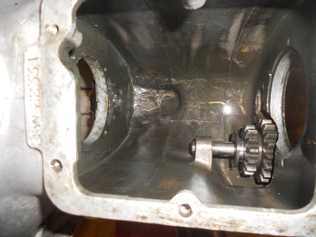

As Peter says the SYN gearbox is likely to be the original with no synchro on 2nd. The 2SYN gearbox is later than your car and the 2 shows synchro on 2nd gear. (Your ebay advert says the opposite?)
I would suggest the original (SYN) box was probably changed because 1st and reverse got very noisy as the straight cut gears wear through their case hardening so you get a harsh growling noise - particularly in 1st and reverse - as the smallest gears wear quickest. The only sensible solution is to find another box with less worn straight cogs and swap them. (The same applies to the 2SYN box in your car if 1st and reverse get very noisy.) I use later gearboxes in my 10 as I had quite a few spare ones in the past and could choose which to recondition and select the least worn gears when recommissioning an engine and box.

Posted: Fri Oct 15, 2021 8:05 pm
Pic to illustrate the small gears (also the gunge that can mess up a gearbox)
