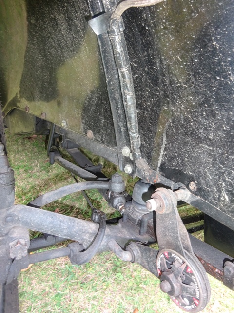

Post by peter_winney » Wed Sep 04, 2024 4:30 pm
