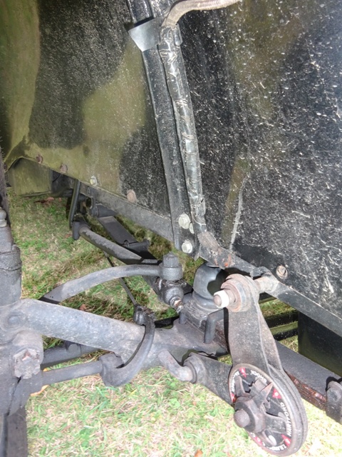

Posted: Wed Sep 04, 2024 4:30 pm
A trouble with the original bump stops on an Austin 10 when cornered with verve is that the spring and chassis come to a stop with a sudden bump. A solution used by one member is to fit Ford Escort rear bump stops on the front springs of the 10 as in the attached picture. These are bigger and more squidgy than the originals and provide a progressive "stop".
